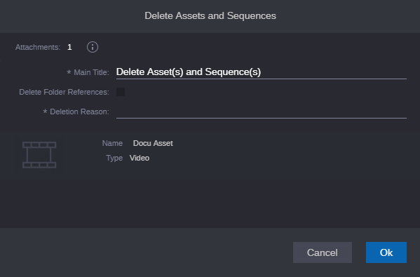

3. Select the Delete Assets and Sequences process type.
The Delete Assets and Sequences process dialog box opens and shows the assets that are to be deleted as attachments.
4. Provide a main title for the process. If you do not provide a title, the default title “Delete Asset(s) and Sequence(s)” is shown as the process title in the Process app.
5. Select the Delete Folder References check box if the reference to the deleted asset or sequence is to be removed from the Browse app’s directory.
6. Provide a reason for deletion in the Deletion Reason field.
7. Click OK.
The Delete Assets and Sequences process dialog box is closed and the delete process is triggered.
8. (Optional) Open the Process app and monitor the progress of the delete process.
