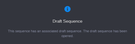

As soon as you save a sequence that includes assets from these two MediaCentral modules, the sequence is identified as a draft sequence. Draft sequences are unique in that they can only be loaded into the Asset Editor by either the user that created it or a MediaCentral Cloud UX administrator.
As the creator of a draft sequence, you can close, and reopen the sequence for editing at any time. When you load a draft sequence, MediaCentral Cloud UX produces a message to remind you about the draft status.
You can click anywhere outside of this window to dismiss the message.
If another user (not the creator) attempts to open the sequence, MediaCentral Cloud UX reports that the sequence is saved as a draft and the user is blocked from loading the sequence into the Asset Editor. Before other users can access the sequence, the owner (or an administrator) must synchronize the sequence.
