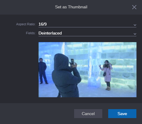

Alternatively, there might be instances where you want to adjust the image’s aspect ratio or field. In this case, you can Shift-click on the Set as Thumbnail button to update the thumbnail in an interactive mode. The following illustration shows the Set as Thumbnail window.
When the window appears, you can adjust the following parameters:
- Aspect Ratio: Select either 16/9 or 4/3
- Fields: Select either First, Second, or Deinterlaced
If you alter either of these options, the image preview is updated in the Set as Thumbnail window.
Click the Save button to update the thumbnail or the Cancel button to abort the change.
After you click Save, the Set as Thumbnail button flickers briefly and then turns green to provide positive feedback of the action.
