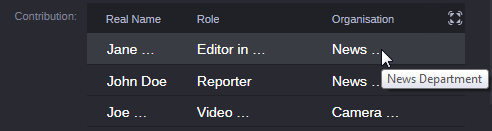

In the Metadata tab, each multi-value compound property is presented as a table, with the labels of the sub-attributes as column headers. All columns have a fixed width and cannot be resized; you also cannot change the column order. If the sub-attribute value cannot be displayed, the text ends in an ellipsis. Hover the mouse-pointer over the field to show a pop-up with the entire value.
The table shows up to five rows at maximum. The table is read-only. When hovering over the table header a button is shown at the right side of the header that lets you open the multi-value compound edit window. When the multi-value compound property contains more than 5 entries, a button is displayed at the bottom of the table, which shows the number of additional entries of the multi-value compound property, for example “+20”. Clicking this button (tooltip “Show more items”) opens the multi-value compound edit window.

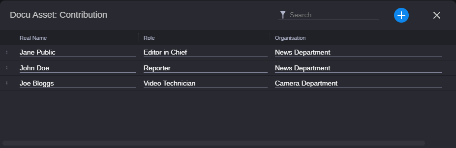

The multi-value compound edit window opens.

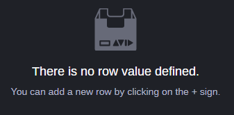

If the property does not contain a value yet, the following message is shown.

2. To add a new row to a compound property:
a. Do one of the following:
*To add a row at the top of the table, click the plus button.
*To add a row before another row, select the row and click the plus button. If you have selected multiple rows, the new row is added before the top-most selected row.
The row is added and highlighted for editing. The cursor is positioned in the first non-boolean property.
b. Edit every field of the row as you would for a single-value property. For each text sub-attribute, the displayed text length is limited to one row. When set to edit mode, an editing field with a maximum height of 10 lines height pop-ups; if your text exceeds this limit, a scroll bar is show.
