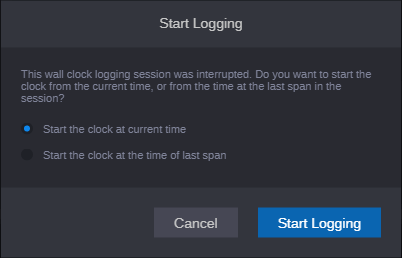

When you continue logging an already logged session against the wall clock, you are prompted to set the wall clock mode: start the wall clock at current time or at the Out timecode of the last span.

2. Click the Start Logging button.
The Start Logging prompt opens.
*Select the “Start the clock at current time” option button to start the wall clock at the current time according to your timezone.
*Select the “Start the clock at the time of the last span” option button to start the wall clock at the out timecode of the last span.
4. Click Start Logging.
The prompt is closed. The Start Logging button is replaced by the span creation controls and the wall clock, which either starts at current time or time of the last span.
