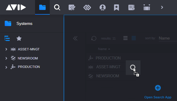

*Place your cursor over the icon of a core app in the Fast Bar and drag and drop it to the main area of the user interface.
If you do not have any other apps open, the new app is added to the main area of the user interface.
If you already have a core app loaded into the main area of the user interface, the drag action adds the new app to the main area and docks the original app.
As shown in the following example illustration, the Browse app is open and the user is in the process of dragging the Search app to the main area of the user interface. MediaCentral Cloud UX provides graphical feedback by outlining the area in blue and showing the name of the app.
