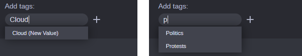

2. Enter a tag name in the text field that appears to the left of the Add button.
As you type, a menu appears below the tag name. If your text matches an existing tag, the menu displays a list of options that you can select. If you are creating a new tag, the menu informs you that this is a New Value (as illustrated below).
You can press the Tab key or click the Add (+) button to enter additional tags.
