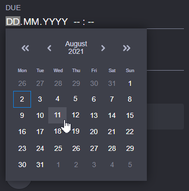

Working with Date Fields
When you select a field that requires you to enter a date, the Collaborate app displays a calendar that you can use to enter your required values. As shown in the following illustration the calendar includes controls that allow you to quickly jump to specific days, months, or years.
The following controls are available in the date picker:
Icon
Purpose
Description
Back or Forward (large)
Click these buttons to go back or forward by a larger amount of time. The increments change based on your current location in the calendar. For example if you are on the initial calendar page, these buttons advance the date by one year at a time.
Back or Forward (small)
Click these buttons to go back or forward by a shorter amount of time. The increments change based on your current location in the calendar. For example if you are on the initial calendar page, these buttons advance the date by one month at a time.
Example:
Current Month and Year
Appearing between the back and forward controls, you can click this button to display to a monthly view in which you can select a specific month within the current year.
If you click the center button again, you can select a specific year (10 years displayed per page). In this case the back and forward buttons increment by either 10 or 100 years at a time.
Example:
Current Day
The calendar displays today’s date with a blue outline (shown left in this example).
After you select a day, the value is highlighted in blue (shown right in this example).
