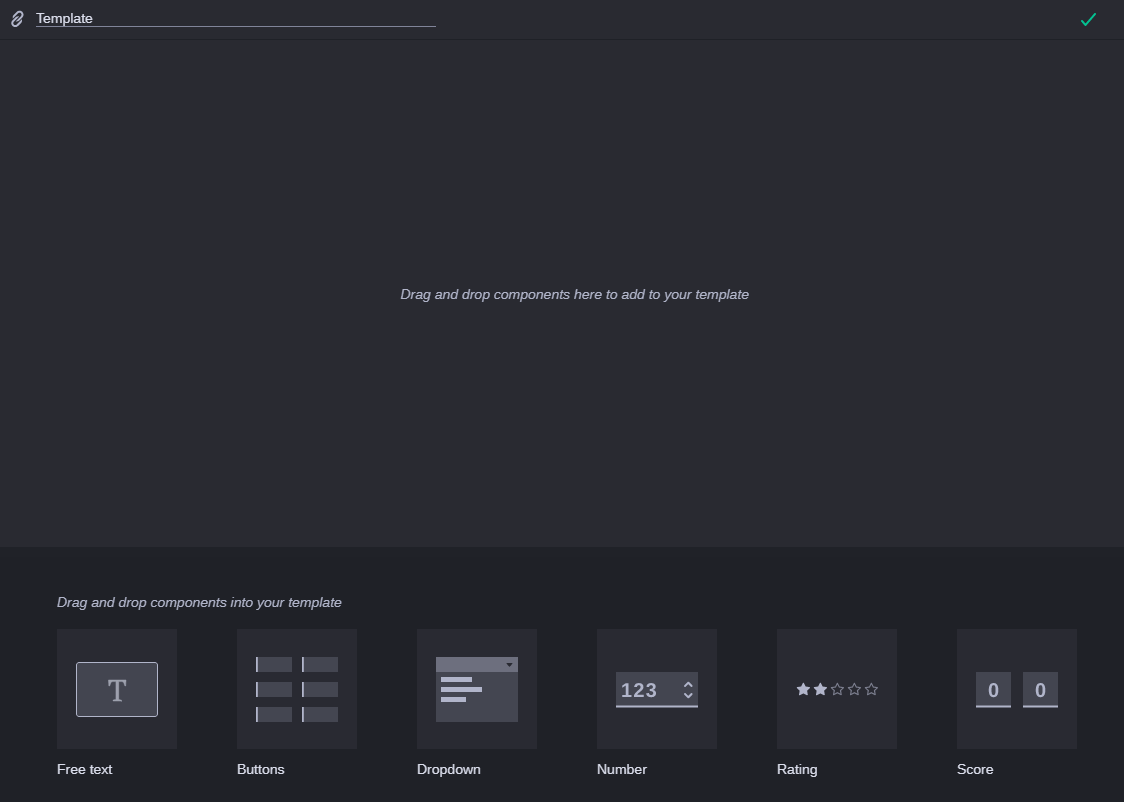

1. Click the Edit button in the template header.
The template switches to edit mode. The empty Visual Logging area and the Toolbox open.
2. (Optional) Resize the toolbox height or hide the sidebar.

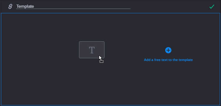

3. From the Toolbox, drag the icon of the component you want to add to the Visual Logging area, as shown in the following illustration for a text component.
After you release the mouse button, the component is shown in the Visual Logging area. The first component takes one third of the template width and the entire height.

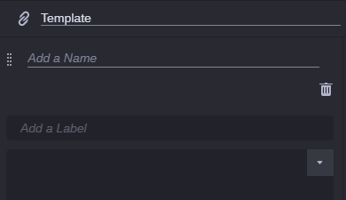

4. Name the component by typing a name in the Add a Name field. This name will be shown as header of the corresponding column in the Text Logging area.
5. Edit the component settings. Which settings can be edited depends on the component type.
