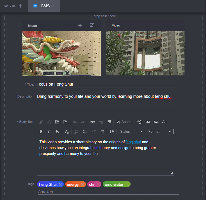

The endpoint appears as a new tab in the Send To area of the app. The following illustration provides an example of a CMS job that is ready for publication.

4. Add a title to your package by entering text in the Title field.
Avid does not impose any character limits on this field. See your CMS administrator for additional limitations or requirements.
5. (Optional) Add a short description to your package by entering text in the Description field.
6. Add a message to your package by entering text in the Body Text field.
You can modify and customize the look of the body text by using a set of tools common to many text editors. If you place your mouse over any of the buttons, a tool-tip appears that describes the functionality of the button.
7. (Optional) Click on the Add Tag field and enter text to create a custom tag. After you are done typing, press Enter (or Return on a Mac keyboard) to add the tag.
You can increase the likelihood that users will find your content by adding one or more add keywords or tags to your package. Each time you add a tag, it appears as a “pill” in the Tags field. You can add one or more tag as shown in the following illustration.
*After adding a tag, you can easily remove it by clicking on the “x” to the right of the pill.
