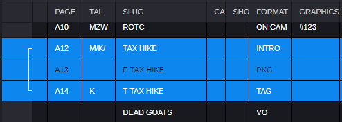

You can group stories within a queue to link them together. For example, a producer might want to link a presenter’s intro and tag before and after a reporter’s package as a story group within a rundown. When stories in a queue can be grouped, a Story Group column appears as the second column in the Queue section located next to first column of selector buttons.
You can only create groups from contiguous stories.
The following illustration shows selected stories in a story group.
