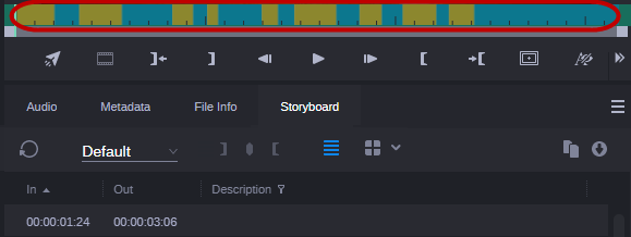

• If the segments are sequential — the Out mark and In mark of adjacent segments are always adjacent frames — in the stratum, the Media Viewer timeline shows alternating orange and blue segments, as shown in the following example.

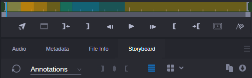

• If the segments have gaps, the Media Viewer timeline shows the base green timeline color between the alternating orange and blue segments, as shown in the following example.

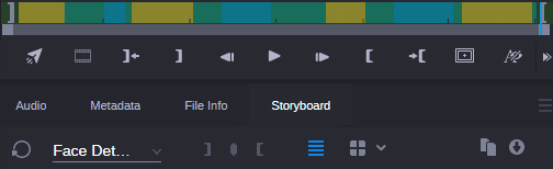

• If the segments are overlapping — segments that share one or more frames in the stratum — the Media Viewer timeline shows alternating orange and blue sections that represent the individual segments. Overlapping segments are represented by a darker shade of the same color as shown in the following example.
